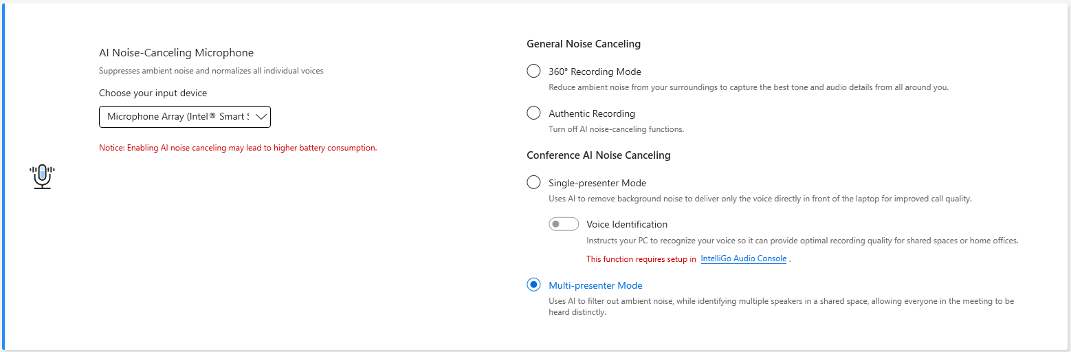

AI Noise-Canceling Microphone *It is supported starting models with Intel Tiger Lake / AMD Lucienne platform. You can go to ASUS website to check the CPU platform of your device.(For Comet Lake platform, only support X409FAC/X509FAC/UX535LH/UX535LI)
AI Noise-Canceling Microphone feature allows users to filter out ambient noise and normalize all individual voices from different positions for optimum group conference-call quality.
Single-Presenter mode: AI noise canceling that filters ambient noise and other voices. This mode allows only the voice of the person in front of the PC to be heard clearly.
Multi-Presenter mode: AI noise canceling that filters ambient noise whilst identifying multiple voices from varying directions and distances and normalizes voices by adjusting all voices to the same volume level.
*The quality of AI Noise Canceling-Microphone depends on different applications.
For the product produced after 2023, you may see the AI Noise-Canceling Microphone user interface shows as below. You could adjust it depends on the circumstances (Studio-quality or Conference call)
Besides, Target Speaker Tracking function could be set to on under Single presenter conference call. This features could targets and tracks new talker to improve the signal-to-noise ratio and enhance recording quality.
*Small core CPU DO NOT support Target Speaker Tracking
